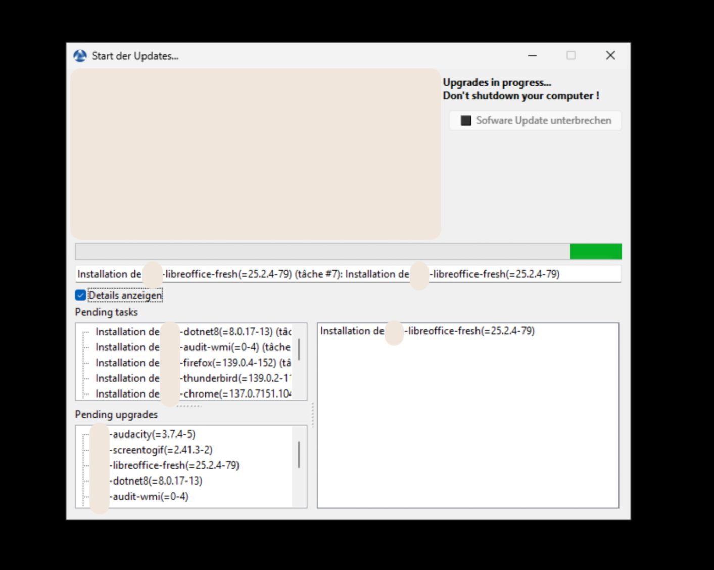

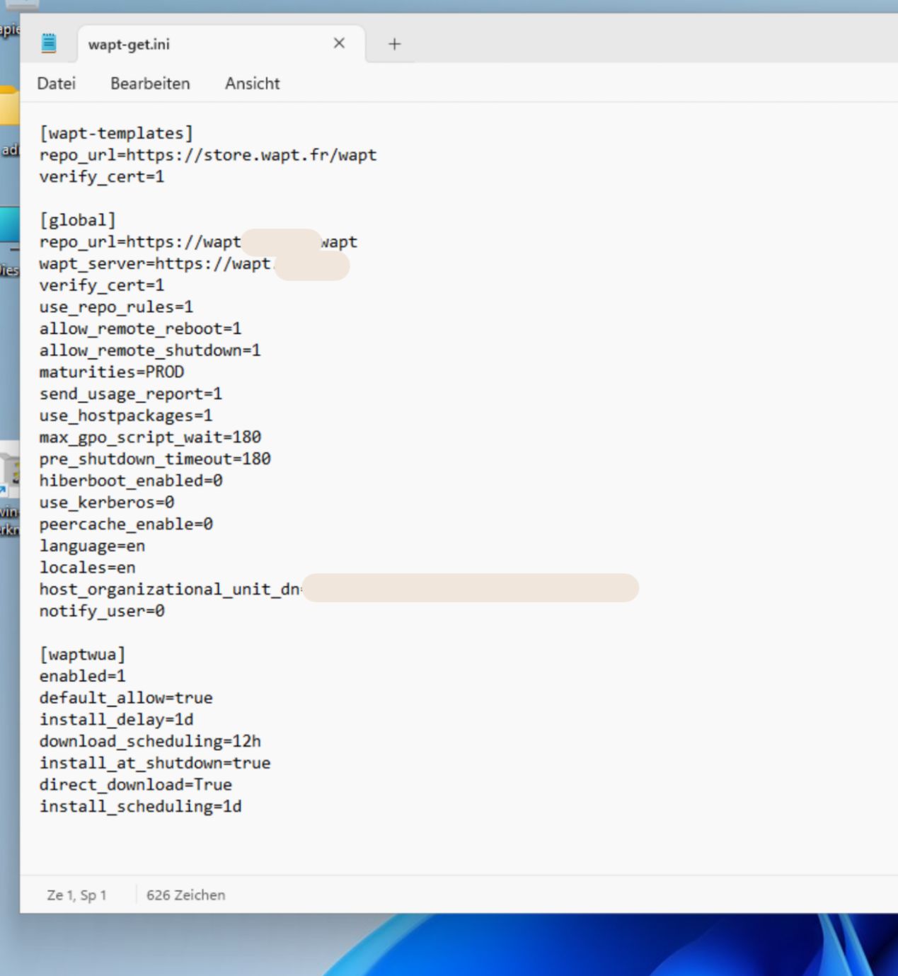

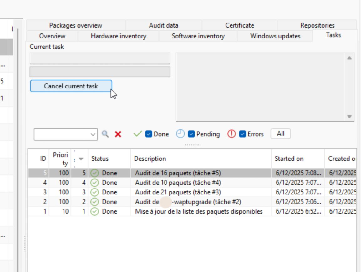

I have currently an issue that all my Win11 WAPT clients and the console show a weird language mix of English, German and French - this started a few versions ago, but didn't bother me personally too much - however user started complaining ...
Attached are some screenshots taken while running a previous WAPT version. However, Console and agents are now on the latest version 2.6.0.17392-0ac7bf48, but are still showing the same behavior.

For the German part, it shouldn't be there, we had removed the translation a few years ago because it was not properly maintained (not enough demands at the time) but there was a few pieces that were not properly cleaned up. It should be ok in the next version 2.6.1 coming in the next few days. We will re-introduce other locales as German or Spanish at some point in the future.
The French part that you get in the service in the tasks feedback it should already be fixed in the 2.6.1 version (there was a regression here).
Sorry for the inconvenience.
